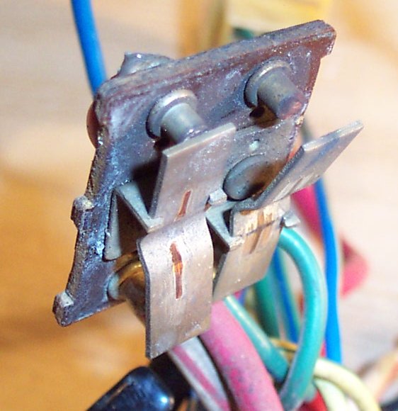

I've done it on my '72. Take the switch apart, removing the little switch "box", it comes off with 2 or 3 philips screws, then use a small screwdriver to pry the little "tangs" that hold the inards inplace, remove the two contactors, using emery cloth clean them up along with the contact post's re-assemble and your good to go.....

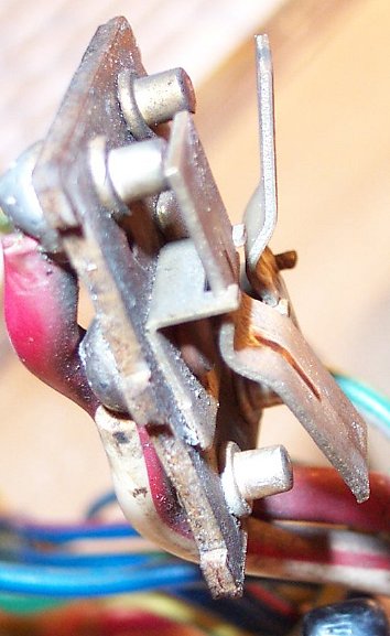

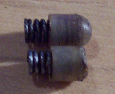

I currently have 2 stalk switches in for refurb, for the headlight switch there is a 2 pole rocker contact arrangement which is operates by a cam, this switch rocker (copper) is actuated by a small plastic "tit" for want of a better word (there are 2 of them one for side lights one for main and they act like pivot points on the copper rocker) make sure this is not worn down -- if is, build it up with JB, its a temporary fix but it has been holding one of mine up for 6 months of constant use -- be careful they have a small spring inside that loves to pop out when you are disassembling the switch.

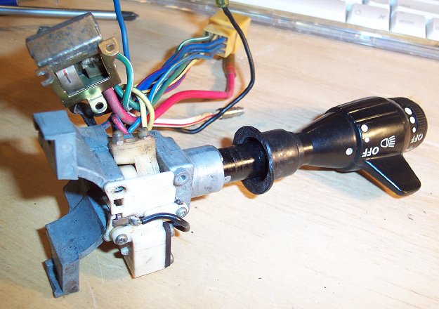

So I pulled the whole comination switch out and pulled it appart.

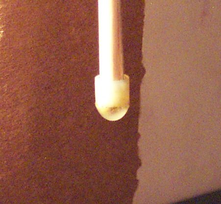

Now what I have done is cleaned up the end of the "tit", then made up a small amount of the epoxy resin I use for fibreglassing my model boats. I shoved the "tit" on the end of a skewer, then dipped the end of the "tit" into the epoxy resin. This leaves a nicely rounded drop on the end of the "tit" with almost exactly the same profile as it had when new, as can can be seen in this pic.
That should hopefully be well hardened by tomorrow morning. The resin can then be filed back anywhere that it may be slightly out of shape, but I'd guess it will be pretty much perfect.
