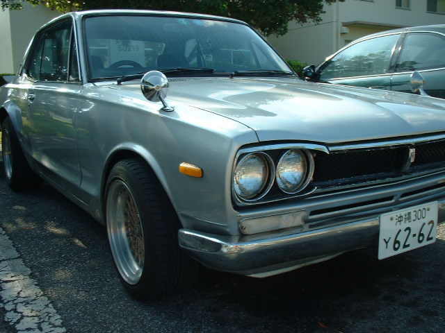

January 31, 200421 yr Author comment_66645 Well put the word out downunder. I want to take the whole rotating assembly this month to SunBelt racing Engines in Atlanta for a complete balancing job from the front pulley to the flywheel. There is a NOPI Nationals Show in March at Panama City. I want to be there to show off my Hakosuka GTX. Link to comment https://www.classiczcars.com/forums/topic/9946-l20-connect-rods/#findComment-66645 Share on other sites More sharing options...
