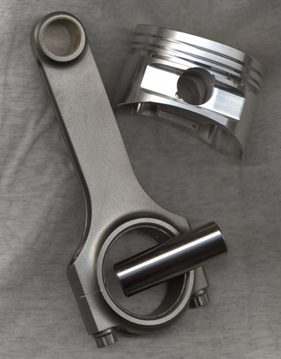

February 15, 200421 yr comment_68485 Greenmonster80 I am also building a stroker with the LD-28 crank, but I'm only going .040 over and should end up with 2964cc. I wanted to fit in the longest rod that was physically possible. So I called Carrillo. They had some and listed them as L-16's. But these are 140mm (5.511") long, and I thought L-16's were 133mm long. I then called JE Pistons and had pistons made to match the rod length and stroke. Look at the picture and you'll see there is no way to fit a longer rod in an eng. with the LD-28 crank. And yes, I had to rob a few piggy banks to get it all. Phred Link to comment https://www.classiczcars.com/forums/topic/9946-l20-connect-rods/?&page=2#findComment-68485 Share on other sites More sharing options...
