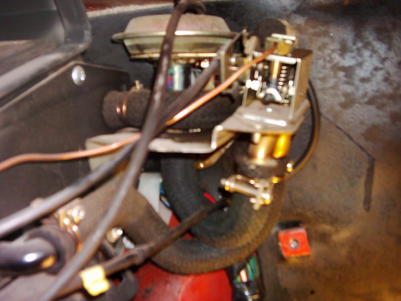

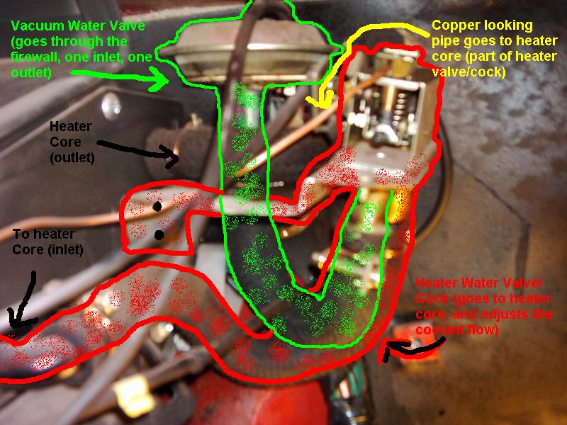

The pictures provided by PrOxLaMuS are great, but will only help if your 260Z is of the "LATE" type. 240Z's and EARLY 260Z's didn't have all that stuff, just a simple water control valve and 3 hoses.

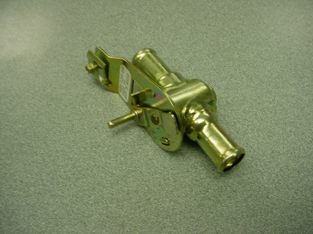

Hey All, I know this will shock some of the purists but I put a Mack Truck water valve in my 72. It works good and matches up with the stock cable. Part number is 25mf213. Costs around $13.
Chris
Here's a pic.
Let's see now, your car has a Mack Speedo cable, and Heater valve, I've got a feeling the Bulldog Hood Ornament and Air Horn must have been on back order! LOL
The silver dog is $50.00, the gold dog is $70--how many would you like Carl? :laugh: :D
Chris
Oh, you'd be amazed how many people around here have them on their pickups!! :stupid:
