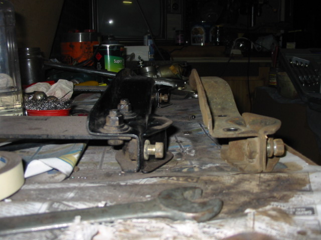

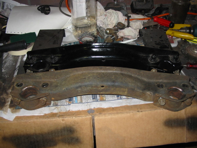

My lower rear transverse link from the a 1972 240z (R180) is Identical to the lower rear transverse link from my 75 260z (R200) (which is the same as a 280z apart form the l26 engine).
See pics. The Black painted one is from a R180, The old looking one is from teh R200.
Even the upright link that joins it to the chasis are the same.
