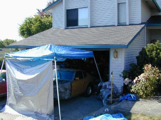

If you are in a residential area where neighbors might complain about the plume of dust you will be kicking up take a look at the one picture I'm appending. You will see a sandblasting "booth" I made in my driveway.
It's made from one of those 10x10 pop up canopies with heavy duty tarps wired to the frame. Be careful to NOT overload the frame with the weight of the tarps, but you don't want lightweight tarps (They'll shred very easy if you blast them by mistake!)
