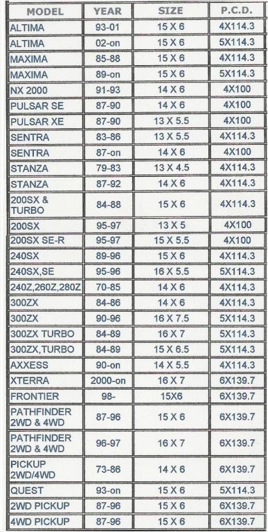

Originally posted by Teranfirbt
I'm pretty sure the bolt pattern on these cars is 114.3x4?
If so check out the billet series that centerline has, they will fit it great.
Sentra rims WILL NOT fit on a Z. The early Sentra and Pulsar (through 1986) had the same bolt pattern as a Z, 510 etc. But from 1987 on Sentras, NXs, etc. had that 4 on 100mm. The Z is 4 on 4.5" which is 114.3mm. Check out the attachment.
