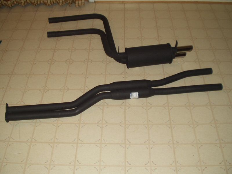

I don't know if this is going to help you, but here is a picture of an exhaust system for a Z styled after the 432 type made by TRUST. Whether it is true to the 432's I am not sure. Alan would know for sure. I have no clue if it would be accurate or not, but you could have 2manyzs take a photo of the undercarriage of his kyosho z432-r. Hehehe. Just a thought. Good luck on finding that 432 set up. That would be awesome if you did that for your Z.
-Ben:classic:
Thanks for the reply v12horse, I was thinking of gathering together some pics and finding a decent exhaust shop to fab up something similar connected to set of 3-2 headers without the collector.
This will help a lot.
Pics of the system installed would also be very useful
Thanks

I see you have had some good help from v12horse already. I can recommend the TRUST system, and many Japanese owners use them on their cars. The centre resonators are not exactly the same as the originals ( which used a single long and slightly flattened oval box ) but it looks correct in most respects and sounds good. They are fairly inexpensive too.

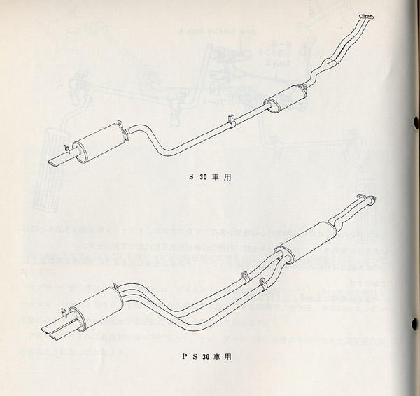

Here's a pic comparing the standard L-series 6 system with that of the S20 system. Its from an official Nissan publication. Hopefully it might help a little?
Cheers,
Alan T.
