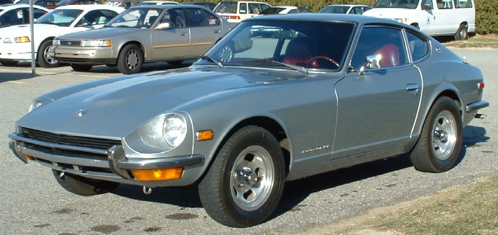

I want to replace the entire exhaust sytem on my stock engine 72 240. The current setup is aftermarket and doesn't even fit the car. The things I am looking to achieve with a new exhaust system are more horespower and a better sound - not too quiet, not too loud, but sounds like it's got some muscle. As far as price goes, I don't want to go crazy, but I don't want to go cheap either. :) So given that and given that I'm car illiterate, my questions to you are:
1) Should I use headers?
2) What is the desired configuration behind the headers/manifold?
3) What type of muffler should I use? Should I add glass packs?
4) Should I go stainless steel?
5) Where can I go for parts?
6) Anything else I need to think about?
I really appreciate any help. I'll be sure to post results when the time comes.
BTW it's for this car:
