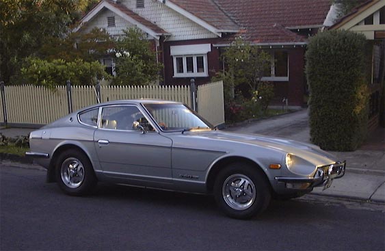

I forgot ot attach a picture. this is one I found on a Japanese S30 site. I think it is probably an Australain car out of NSW or Victoria, great looking car, look at the mirror on the door that is the one I think is the most common.
Cheers
Steve:classic:

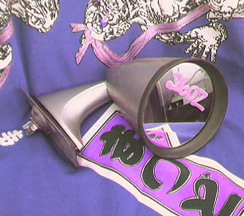

I noticed on a website here in Aus that a bloke was flogging a couple of 240Z mirrors he said he picked in Japan in 1997. The for sale was date 1 October 2002 and you never know he may still have them. He mentions that they were optional extra from the catalog of the Z. He was based in Melbourne.
I have attached a picture of these

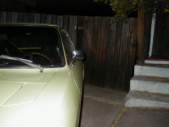

70 ~ 73 came with 1 divers side, door mounted mirror. As described, Chrome base, Stainless back, flattened oval. These were only sold as left (drivers) mirrors. I installed one as a right side mirror as well and it works (sort of). I needed to use a 3'' convex "stick on" mirror on the passenger side mirror for it to be any use.
Here's a photo of my car with both mirrors visable.

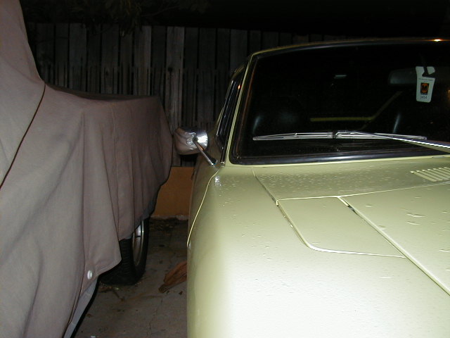

Senor Ozlime,
That is exactly the match for the U.S. Mirror. MSA Has the left side match for you. Part #30-8140, $85.31 USD.
Taking your lead, I went out and shot these photos of my mirrors.
By the way, That car of your's has a great color :love:
