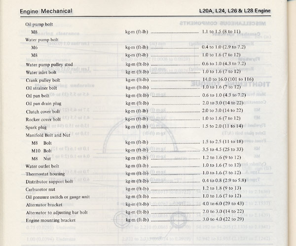

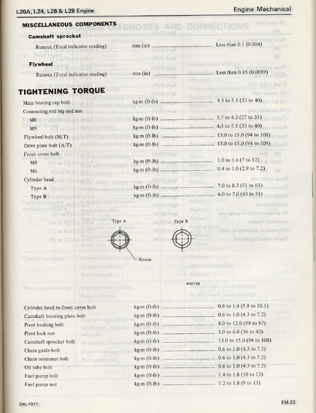

Good question, I'm also rebuilding a '81, F54. I have been using the torque specs specified in my service manual which has specs for L24-L28 70-78. I hope they are the same. BTW you shouldn't re-use the rod bolts. I would highly recommend either getting some new ones or go with ARP.
Thanks Alan
Your torque values in your Dec 77 manual are the same I have.
