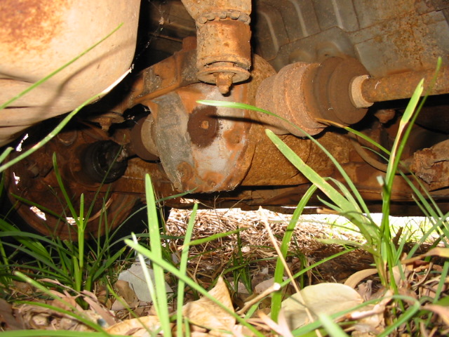

I have a photo of a R30 L20 turbo GT that was for sale for $1200. It was a 4 door sedan. I took some pics of it, and in a pic of the Diff you can see the back of the wheel with the mounting bracket and the caliper.
The photo aint the best, but that looks like a disc setup.
