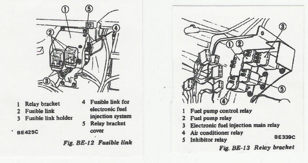

hi again~S~. the good news is that the car will now start and run under its own power. everything works like it should. I ended up replacing the ignition relay above the fuse box, and re-attachintg a ground wire that was dangeling up in that area as well. I also found another ground coming off of the injector harness that was extreamly loose. now onto the next step of getting this poor Z car road worthy again...it needs u-joints BAD..LOL. I want to thank everyone who has helped me on this. it is greatly appreciated.
