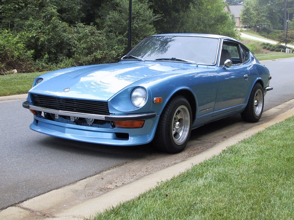

I'm looking to upgrade my tires and wheels from 185/75-14 to 205/60-16. However, I don't care for the really low profile tires and was wondering how this combination would look. Do you have a picture of your wheels and tires that you could post.
Thanks
Greetings MikeW,
Thanks
Here ya go ...
