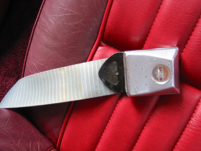

My last 240z which was a 1972 car had seatbelts with chrome buckles with Datsun written in red lettering across the buckle (from memory)
Another car I owned had belts with chrome buckles with just the letter Z on the release button, can anyone please advise if either of these was from a 1970 car, if it was'nt either of these please advise what is correct.

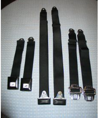

The earliest cars had non-retractable lap belts and shoulder strap with a solid black buckle. The top of the buckle lifts to release - like airline buckles. This is a set of them. Take notice of all the hardware. It is different from later types.
The first picture posted (lift up handle on the buckle) are seat belts that are identical to hose in use on the Roadster 2000 and the 1600. I can't recall if they were in use on the very early Z's, but it would stand to reason that Datsun would have used them on the Z as well.
The second picture with the Z logo on a silver background and the black housing are what my car has. I'm pretty sure that is what most Z's have. The shoulder harness clips onto the back of the buckle by aligning the buckle and the shoulder harness buckle and then rotating 90°. If these are the ones you go for, take care to ensure that the concave washer under the attachment rivet is in good condition as this is what keeps the shoulder harness from slippng off the belt.

The first Picture is for the 1970 model year
The second picture with the Chrome Z push bottom came with the 1971 model year
