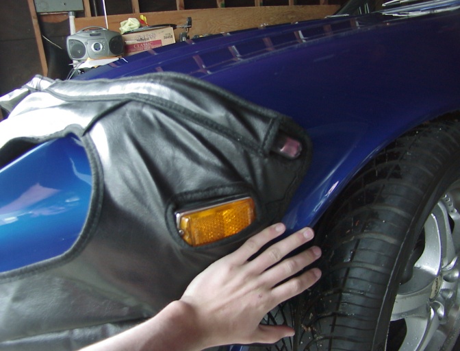

Like Rob said, put the car out in the sun for an hour or so, with the bra laying on the car as it is in your pic. It will stretch out a bit after it heats up. I have the same problem with the bumper cover (bra) on my Ram, the first time I put it on, it's nearly impossible to put on, once it warms up and you get it on, after that it's pretty easy till you don't use it for a while again.
Never put a bra on a dirty car, the dirt and grit on the paint will mess up a paint job in no time.
Never leave the bra on if the car gets wet, take the bra off and let it dry, off the car.
Never let the bra flap in the wind either, if it doesn't fit tighly across the hood, and loosens up too much, just the bra itself vibrating up and down in the wind will leave marks in the paint. Even if the car is spotless.
Don't ask how I know this....:disappoin
