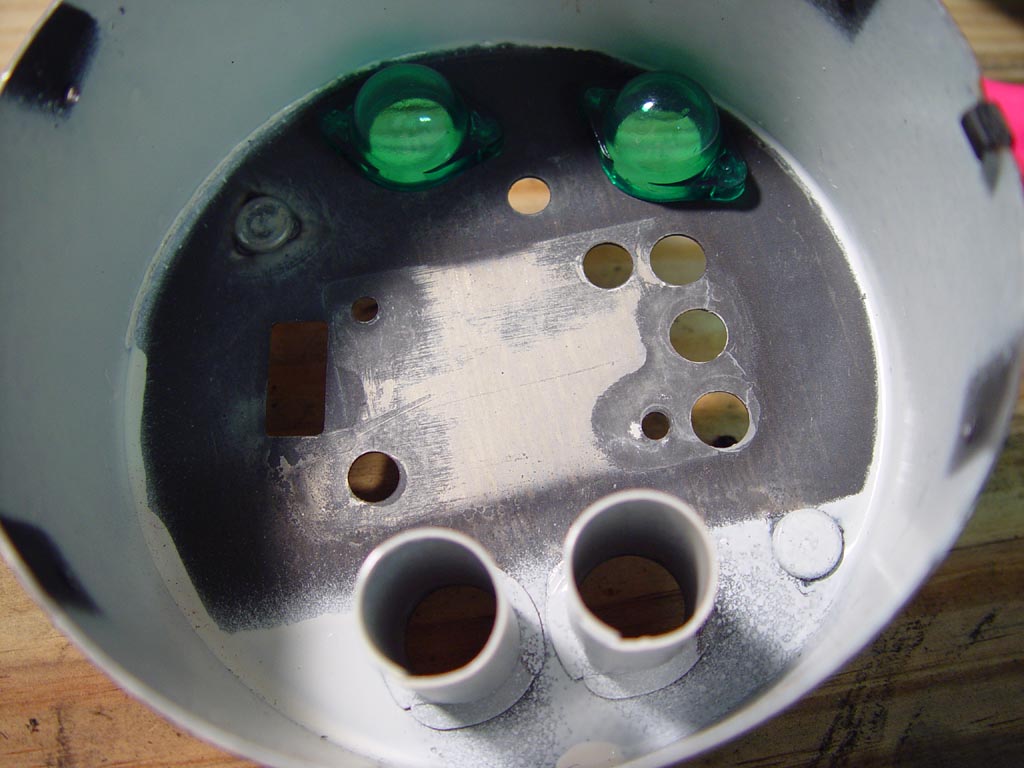

Have any of you guys found a trick to getting that second PCB off the back of the tach housing?

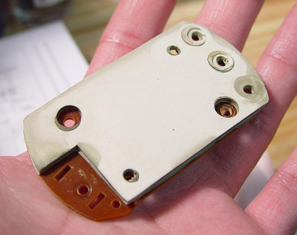

In the tach from the 240Z it was glued on by some bondo-looking stuff, and I only managed to get the board off by using a punch on the hardened-putty stuff from behind (and shattering the PCB on the other side of the putty in the process).
This isn't a big deal, since I am swapping it out anyway, but the 280Z tach has the same stuff holding the back board down and I certainly don't want to damage this one too.
Attached is a picture of the stuff in question that was between the back PCB and the housing.

Well, the cold seemed to cause the putty stuff to gum up slightly.
I was able to use some small screwdrivers to pry up the inner edges of some of the holes and pry it out from behind little by little.
Now I just need to wait for it to dry off. It's a pretty humid day today so when I bagged it up and put it in the freezer, some frost developed in the few hours it was in there :stupid:
Use a hairdryer to dry it off. If you are going to glue it back in use something like superglue, if you use RTV be sure to get something that is compatable with electronics, regular RTV offgasses something that is very corrosisve and will make a mess of the electronics!
