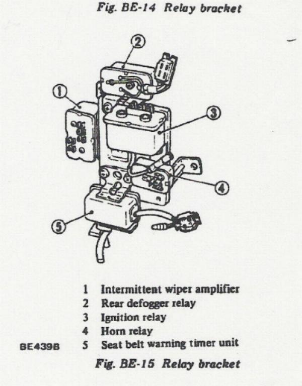

sblake01 Posted April 30, 2004 Share #7 Posted April 30, 2004 You might try checking the ignition relay-right kick panel below the dash: Link to comment https://www.classiczcars.com/topic/11458-car-wont-start/#findComment-79137 Share on other sites More sharing options...
z_boi Posted April 30, 2004 Author Share #8 Posted April 30, 2004 tanks for the picture. i was tryin to figure out where to check for the relays with my books but theres jus wiring diagrams. Link to comment https://www.classiczcars.com/topic/11458-car-wont-start/#findComment-79138 Share on other sites More sharing options...
