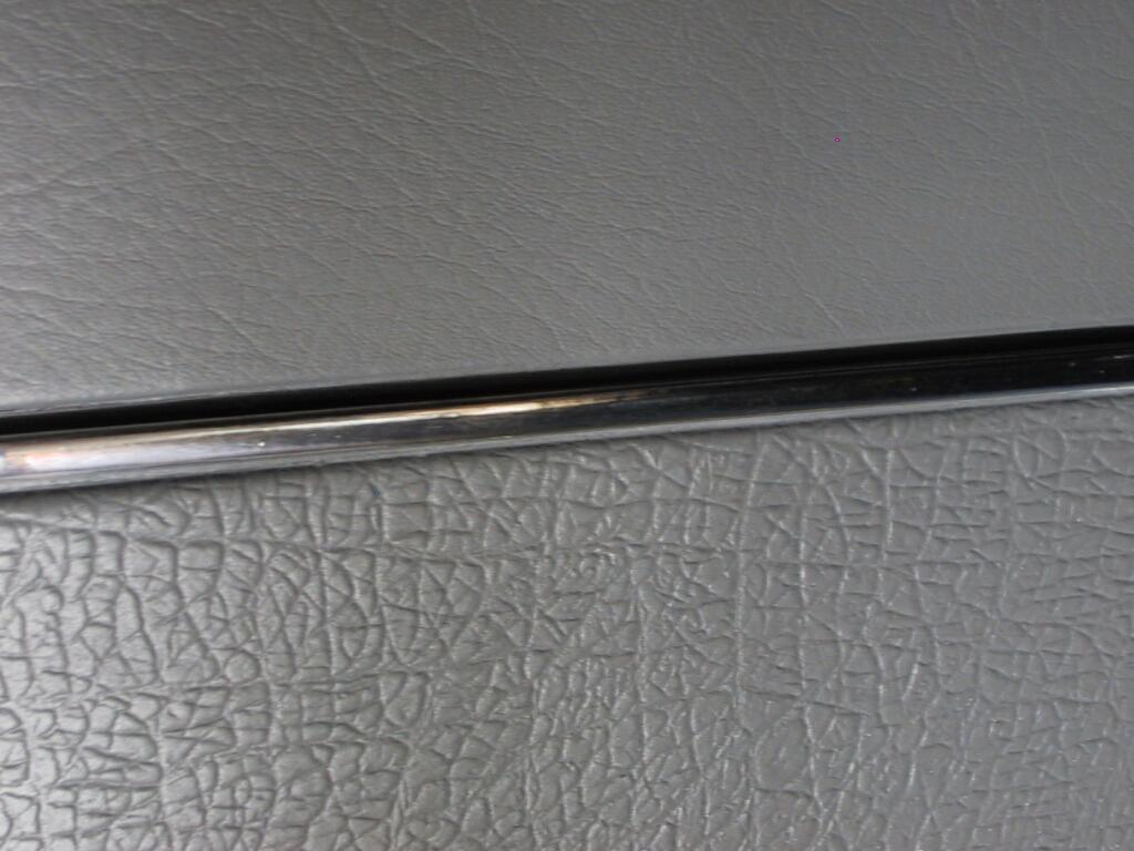

I've done this and was quite happy with the outcome. I used metal repair tape which I then polished. At first I polished it using a board to back it up but the wood grain pattern came out on the tape. I then used a clean piece of plexiglass to avoid that particular problem. After getting it highly polished I used a metal straight edge and a razor cut a 3/8" x 34" strip. The metal tape will easily hold the radius required unlike some metallic pinstrip material that I had tried earlier. I had to peel off a few remnants of the orginal material to get a nice smooth surface. The only tricky part was making sure that it was aligned properly. It would be quite difficult to do with the door panel on the car because the tape would want to sag. I took the panel off and placed it flat on the floor to avoid that problem.
Keep in mind that it's quite difficult to photograph this properly but attached is a good attempt I shot a few minutes ago. Please note that my door panels have been dyed gray.
