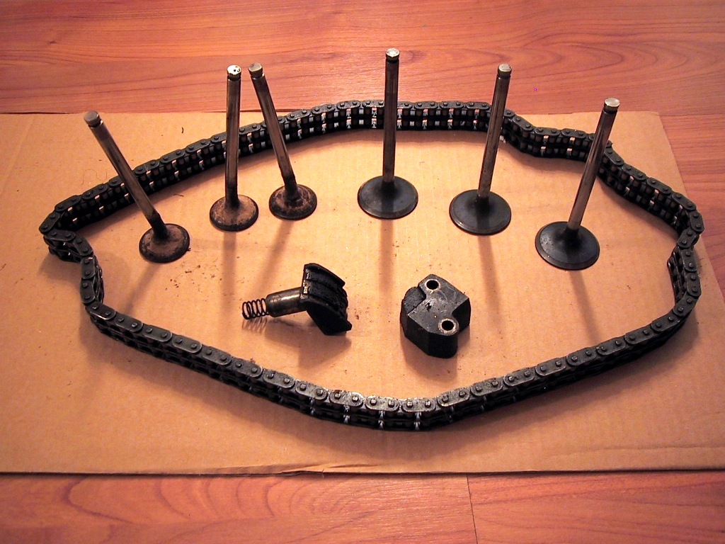

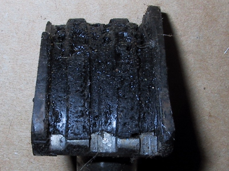

It wasn't my engine, but..........
From the looks of the VERY deep grooves in the tensioner "shoe", I'd say it's likely that the tensioner quit "tensioning".

I had to replace the head gasket and apparently failed to sufficiently wedge in the block of wood holding the tensioner in place. When putting things back together I had trouble getting the cam spocket back on and had to use a bit of leverage to coerce it. This apparently weakened the tensioner because a few days later while driving everything went bad in a hurry. It appears as though the tensioner broke which in turn caused the chain to slip.
Keep in mind that I was a dumb teenager at the time (before helpful intenet resources) and only figured what I had done wrong after the fact.
So we could conclude that it was not the chain or tensioner or cam sproket that caused this directly.
In fact, it was in-correct assembly and no chain or tensioner replacement was neccesary.
