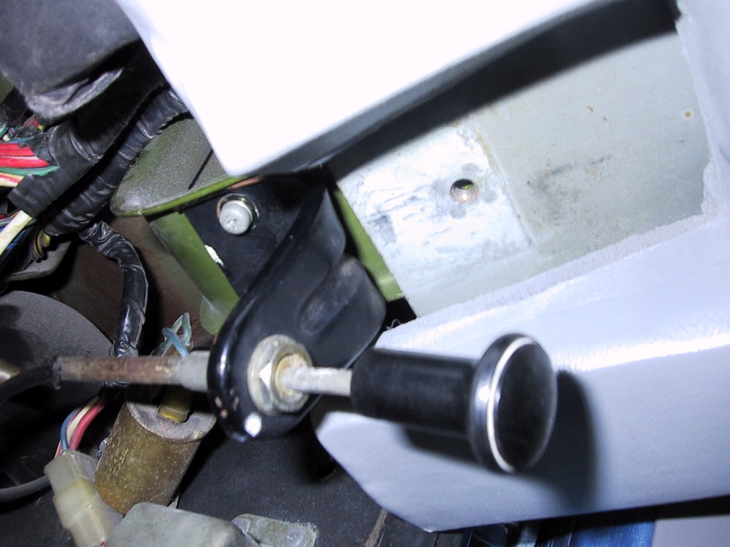

Speaking of the vent knob, I notice that there's an extra threaded hole in the dash right above this knob. It looks like some sort of bracket should go there but I don't see anything listed on the parts CD for this location. Any idea what this hole is for?
I have no idea what those threaded holes are for. It does look like the rod tha your vent knobs mount onto, is corroded somewhat. Maybe some Kroil, or Penephrite would help the operation of the vent control.

That bolt hole is what secures the bottom outside edge of your dash to the car's frame.
That you have a "scuff" mark roughly rectangular in shape that surrounds that bolt hole tells me that the support that you can just start to see through the bolt hole, should be BELOW the dash and not above it.
As far as the fresh air vents, they are held to the kick panel (way up there closest to the firewall and cowl bucket corner by three screws. It is easiest to reach them with the dash out, but it isn't totally impossible to do it with the dash in place, just be ready for some yoga calisthenics.
Once out of the car you can check to make sure the plastic sleeve is still intact and not broken, and that the cable that operates the flap is operational.
