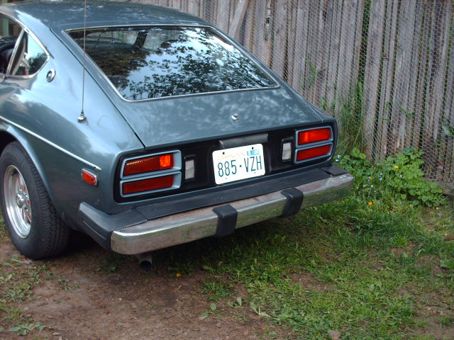

For the inside of the lens mild soap and water with a soft bristled toothbrush works great. As for the outside, some 1000 grit or finer sandpaper, wet of course, and some Meguire's plastic polish, clear or colored depending on your application and this is what you get..nice and clean and shiny. The chrome I sanded and tried to paint match to the body color. Now my beautiful princess looks like she has her makeup on.
