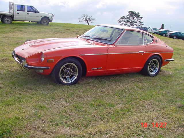

No digicam Geoff but I've got some pics on film being developed so they could be scanned. Have a look in my gallery, those are the wheels on the car. See also bottom right here except mine all all black in the center, and look a lot better IMHO. http://www.performancewheels.com.au/classic.htm
Offset is 18mm positive which is about perfect for 7" on the 260Z.
The wheels in your pics in the gallery are a bit dark and I wasn't sure if they wre the ones you referred to. As you can see I have 14x7 Challengers with 3mm positive as road wheels on my 260 at the moment. However, I have some 15" Toyo RA1's on 15x6 at the moment for the track and would prefer 7".
