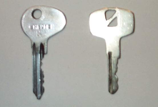

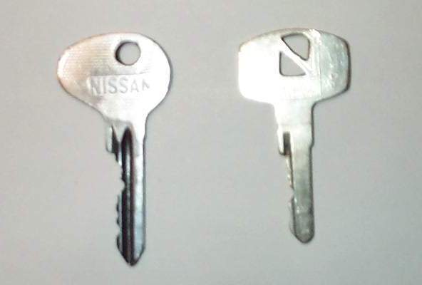

Arne is correct---he steamed the label and sent it to me. It is from his yellow 10/70 build date 71 part-out car. I also purchased his ignition lockset and key. The key is single sided, says "NISSAN" on one side and has the code "VH3913" on the other side with a faint embossing of "KS" below the code number. The "KS" most likely stands for KANTO SEIKI which is cast into the ignition lockset body along with the characters KV-3 and was the manufacturer/supplier. So it's a pretty safe bet that this is all original and goes together. Unfortunately the door key 7862 isn't accounted for.

I have the well worn original Nissan single sided Door key that matches this label. Unfortunately the Ignition Key 3737 is unaccounted for. :tapemouth
Both of the labels for the glove box have the numbers handwritten with poor penmanship. Hard for me to make out without a magnifier! LOL
Attached are poor pictures of these early keys.
Arne's Ignition Key is on the left, my Door Key is on the right in the pictures.
HTH!
Jim D.
