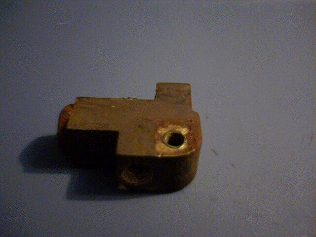

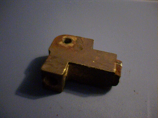

If I did this correctly, the two pictures attached show the "Pressure Regulator Valve" for the rear brakes of my 71' 240Z.
By the way, the Haynes manual uses the exact same term to describe the proportioning valve on the firewall of the 260/280.
The more that I look at this thing the more that I wonder... It appears to be completely sealed. There is one port that connects to the brake failure switch / master cylinder (Inlet) and the outlet connects to the "T" fitting that splits the lines off to the two rear wheels. There is no way that a totally sealed unit like this, with no return path could really regulate a hydraulic circuit.
At best it is a variable restriction in the line... perhaps just a surge suppressor? A device like this would keep the rear brakes from locking first, at least it would on drum brakes, since they are prone to locking on a sudden increase in wheel cylinder pressure. It might just give the front brakes a "Head start" in the braking process.

Looked at the Vic Brit catalog again, and I do see the item you pictured. Not listed as available, and appears in the diagram in very light drawing, and only for 70 -72. Hmmmm.

I thought that there was a long thread about this item just recently. I belive that the 3 way valve in the rear is specific to the s30 with rear drum brakes. It is to keep some back pressure on the rear brakes so that they do not need to travel so far. The thread also said that some people were disabling the 3way valve when they install rear disk brakes.
