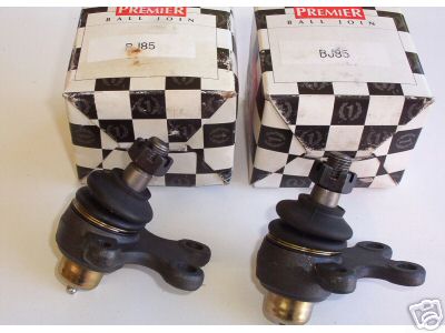

I have seen some very cost effective "Premier" brand ball joints for sale and am wondering if there is any risk involved.

I can't provide specifics for the Aussie market, but in the US, all ball joints ARE NOT created equal. Some are servicable (greasable), others are not (no provision for a fitting). Some are high quality, others are not. Nissan units are indeed expensive (in US). Quality aftermarket Ball Joints are marketed under the Moog, and NAPA names, among others, in the US. GMB brand are low quality ones. Most (good and bad) are made in Japan or Korea. Haven't seen any Made in China (yet)
The Nissan ones are made quite differently from the elcheapo alternatives and IMHO are the only way to go, even the boots are better. They are not cheap but then not much decent is. It may be worthwhile checking a non Nissan dealer who specialises in Z stuff, some of them have OE parts at good prices. I assume DM that you buy at a trade discount :bandit:
I fitted some good but not Genuine Ball joints and found that with the car jacked up that they would bind up before turning to full lock. They might have been ok as you dont normally turn to full lock with your wheels off the ground, but i changed them for Nissan joints at $70AU trade, and they worked fine.

These are what I am looking at for hopefully under $50 a pair, this is a big saving over the nissan parts which makes them worth considering but at the same time I dont want to ruin all my hard work by skimping out on $100 now.
