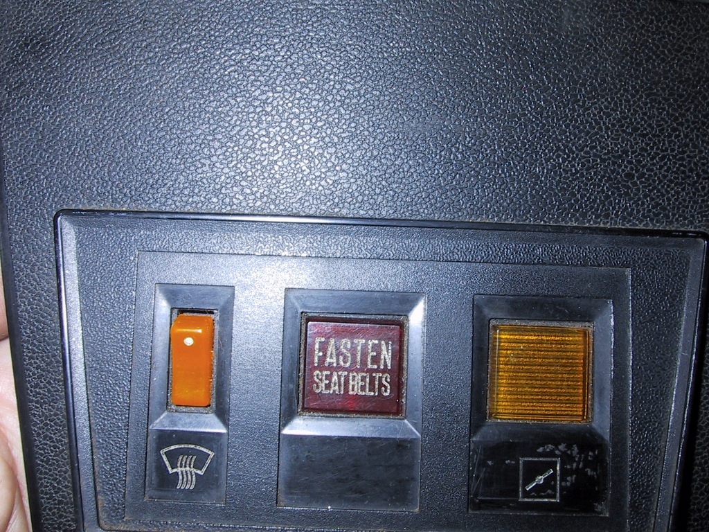

Thanks Enrique, most helpful. So if I'm reading you right on a "series 2" car the "Fasten Seat Belt" lamp in the center of the fuse cover would have been the location of the switch on a fog lite equipped car? If this is so, I wonder where the "Fasten Seat Belt" indicator would have moved to or would the car just not have had one.

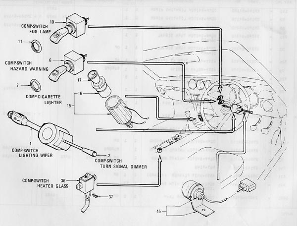

Chris:
Don't quote me as to the location on the "Series II" consoles. I have a picture (attached) which shows TWO of the Parking Light Switches, and purportedly one of them (in the case of the picture I have) the right hand one, is the one for the fog lamps. I've also attached a drawing of a Fog Lamp Switch that Katz sent me. By the way, the console cover is off of Alan T's car.
HTH
Enrique

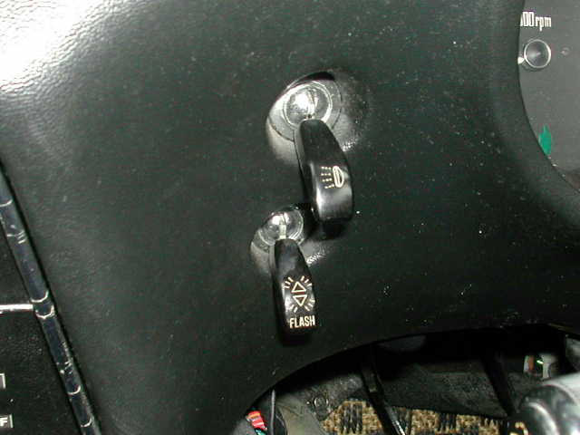

Enrique,
That picture clearly shows that the panel was modified from the original as you'll notice that the center switches have a label added whereas the right switches still show the choke warning symbol. I'd be surprised if that change was made at the factory but I suspect Alan will fill us in. Here's what my panel looks like:
Hi Enrique,
That's an interesting picture of the console cover. It looks like two switches in the center and two switches to the right where the choke like would be on my car. Never ever seen anything like that. COOL!!
Your drawing is a dead ringer for the hazard lite switch in my 72 except my switch says "FLASH" on it I believe.
Thanks for the info.
Chris
