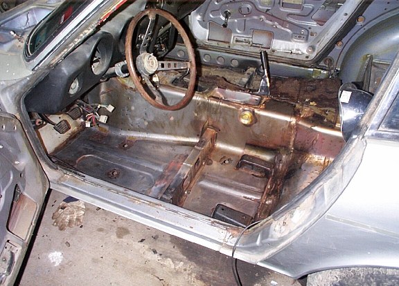

The second bolt that you are looking for is hidden under the vinyl that is glued to the inner sill. Open up either door (driver or passenger) and find the door latch assembly for the door. If you look straight down you should be looking at the selt belt retraction assembly. What you have to do is peel it (the vinyl) from the front to the rear after removing the inside scuff plate (Should have about three or four screws holding the scuff plate down) I'm going on the assumption that you will be replacing the vinyl trim with new trim anyway. Once you get the vinyl trim off you shoulf be able to get at the bolt with a socket or wrench (bolt size should be 16mm) I found a reference picture that I found that shows the right inner sill. (if you follow the seam in the floor that's right behind the rear seat mount across it almost points right at the bolt location)
