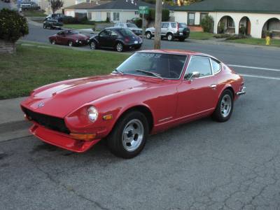

Well, Z's back from painters, and all put together, now time to try ander understand why the front end sits about 1 inch higher than rear. About a year ago I put Eibach progressives in, tokico non-adjustables, and poly bushings. According to searches on this site, the .001 went in the front, .002 in the rear. (by .001 and .002, they are the last 3 digits on the part #'s) Do I need to cut the front springs :mad: Any ideas?
Thanks
Dave

59ghia, This is pretty typical when the springs have been replaced with aftermarket units. Why? Probably because the front springs have a higher rating. Regarding the sway bar, it very unlikely they are causing the front to sit higher than the back, unless they are binding somewhere. As far as adjustable sway bars....the adjustment is at the point where they attach to the control arm. Adjustable sway bars have a number of attachment holes in the end of the bar so you can increase or decrease the amount of force the bar will have....The attachment holes at the end of the bar will be the softest setting and the attachment hole farthest inboard will be the hardest setting. Basically, a sway bar only comes into play when the car starts to roll from cornering forces....they do nothing when going straight! Cutting the springs down is not a prefered method for properly lowering, but has been done. Lets face it, to address the ride hieght problem you will have to take the springs out anyway so you may as well see if you can get a shorter spring...they are relatively cheap. If you decide to cut the springs down, be careful how much you remove. Remember, that by shortening the spring it will increase the spring rate and if you remove too much you have the potential of coil-bind under full compression. There is always the possibility of putting a coilover setup in the front and then you have the freedom to adjust the ride hieght. Hope this helps a little. Good luck and keep us posted on your results.
59ghia, send Eibach an email and ask them.....I'm sure they will enlighten you. This spring manufacture is one of the most respected in the industry! I don't think you should dislike or get concerned about the design...there is a reason for what they do.
