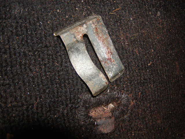

I have these in my '75 280z and they're original to the car!
In 59GHIA's photo you'll notice that one "finger" is flat and the other is curved up. The curved finger is slid between the L shaped tab (that is attached to the floor pan) and the carpet, with the curve up like a bridge or hump and the lip of the straight edge facing up. The photo shows the orientation correctly. I believe this design is intended to hold down the carpet all around the underside of the clip while taking away some of the stress from the carpet hole and the L shaped tab. So, the curved "finger" would be positioned to the rear of the car.
Hope that helps!

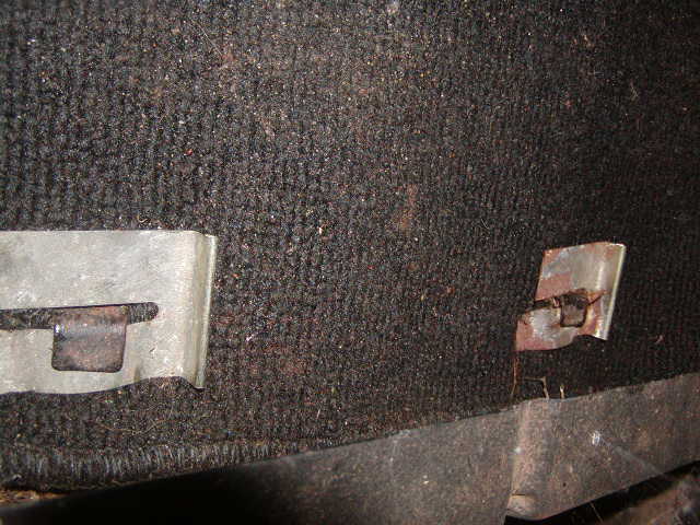

Here are a couple of pics of clips mentioned above..
GunnerRob described perfectly

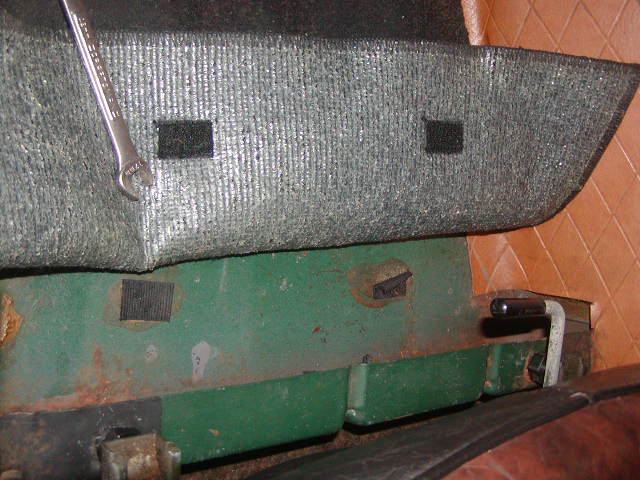

First is early 240 velcro patches
Next is actual installed in early 260, but is same at least back to Vin 40,000.
