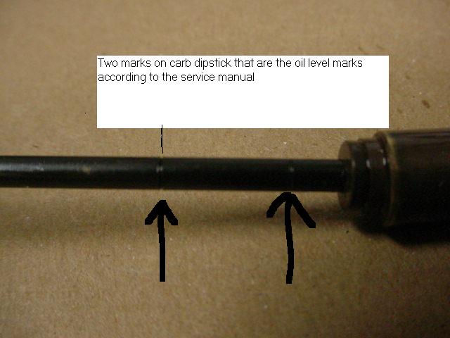

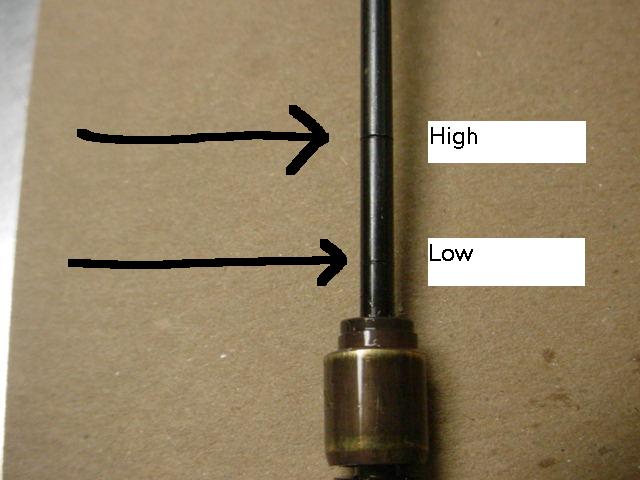

I checked the level of the oil, it seems just right. Maybe about two months ago new oil was put in, and i am not sure if the weight is correct. Can oil go bad just sitting in a container? Because the can for the oil I used looked old
and it did not say the weight.

What kind of oil are you using? Some people use ATF or straight 20wt. Other's use different weights depending on application. And you should fill to the line indicated on the plunger (dipstick). If you over fill don't worry it will spill out into the intake and be burnt off.
