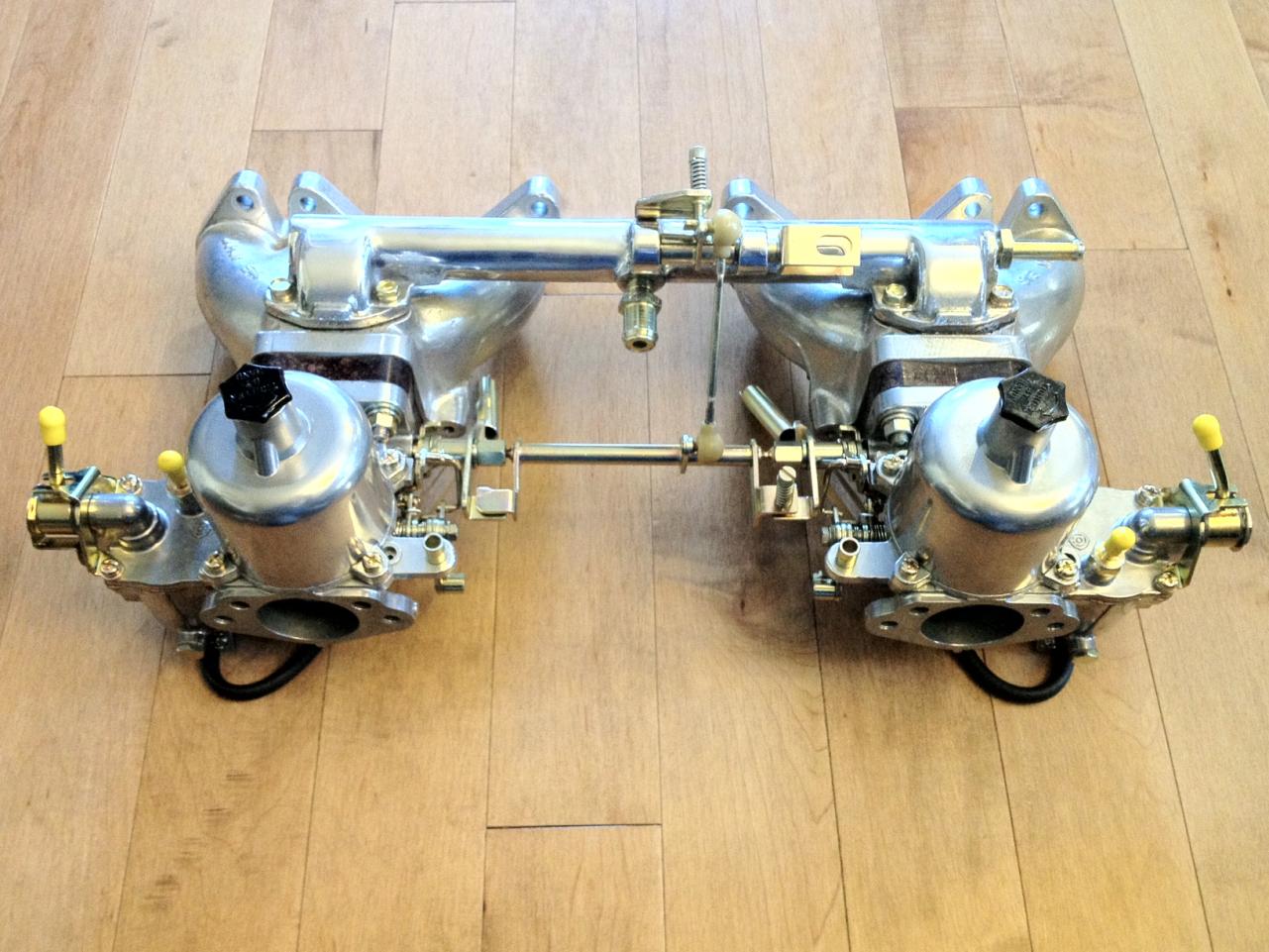

My Ztherapy carbs arrived today. If you want to see what they look like before and after, here is an example. I obviously dished out a little more for the whole works to be polished and redone, but the carbs would be the same as what you're looking for. I didn't take a picture of the new fuel rail, or linkages, but you get the idea.
https://www.classiczcars.com/topic/1341-ztherapy/#findComment-389173
