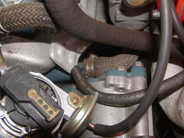

schematic for hoses on stock air box?

Alright guys, youve convinced me to see if i can feel any seat of the pants dyno improvments with the stock air box and air horns, since my Z had aftermarket air filters when I bought it. One more thing, what about the hose that connects the PCV from the balance tube to whatever the hell it is connecting it to down below, does that hose just run UNDERNEATH the airbox??
