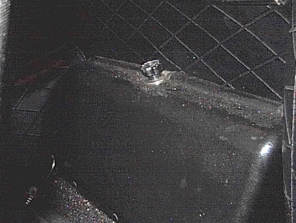

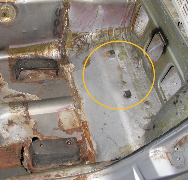

I believe Webdawg1 is referring to this toolbox cover. It is for the Series I not the Series II like in deadflo's picture. Reproductions are often for sale on eBay, at least they were. The price wasn't bad altho shipping made them pretty pricey. Not sure these repros came with hinges, but assume they did. These toolboxes were on the floor behind the seats, not in the rear deck.
I appologize in advance if these are someone's images, I promise I downloaded them for reference purposes only and hope it's all right to share this info. Sorry I don't have any pictures of the hinges themselves but they shouldn't be too hard to reproduce with other materials.
The Series I Tool Box Hinges look more like a plastic style piano hinge, without the hinge pin. The plastic is flat with a thinned out section in the middle that allows the piece to bend along it's length.
The hinges for the later tool boxes are more like your standard small brass hinge you can get at a hardware store for small boxes / doors.
When I was looking to "create" a replacement hinge for a pair of Series I lids, I thought of using either piano hinge, or a rubber strip sandwhiched between the box lids and a piece of flat stock metal, then riveted or screwed / bolted together.
