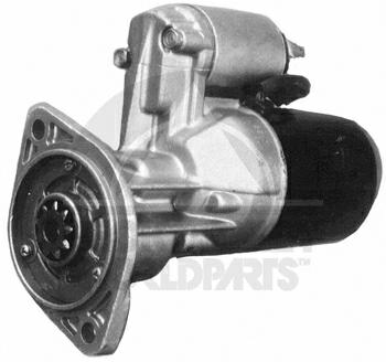

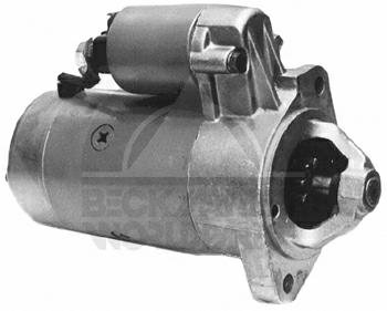

The starter swap was popular, so you might have one with gear reduction!
The gear reduction is also cheeper for some reason. Here is a picture of the gear reduction variety from Beck/Arney
Will
Will, what specifically is the difference? I may be blind but I don't see anything in that pic that clues me in.
There are 4 differences that I know of. I will try to find an
1)The drive gear is not on the same shaft as the motor, it is jogged to one side.
2) the Motor is physically smaller-gearing gives it more torque than the standard starter.
3) The gear reduction starter uses less current
4) The gear reduction starter is lighter
One side note, there are atleast three versions of the gear reduction starter that will fit, and some of them are not smaller, lower current or lighter...
Here are the beck arney pictures of both, I will see if I can get a set side by side in the next week.
Will

Of the 3 versions that will fit, which one is recommended? Looking for information on how to identify, or what year/model of car to look in, or to say that I have when placing an order.
Not that I need one immediately, but it would be great information to have on the site and in my local files as well.
Carl,
The smallest one fits many of the 80s Datsun Pickups, and it is the one I usually use, I recently got one from Autozone($60, after the core) I'll see if I can't find the actual part number over the next several days.
Will
It's not under powered for an L6 (I mean since it's used on 4 cyl trucks)?
I wonder how much difference the weight between the versions and if it's worth worrying about for a street (non-competition) car.
I know, I'm asking lots of questions tonight
No, the gear reduction takes care of the beef!
From memory I think it is about 4lbs lighter-but that is not measured, if I get the time, I will pull it back off, and picture and weigh it against the other two(I have a couple of used ones for cores)
Will

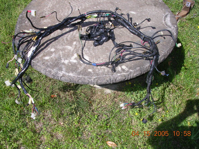

Texasz,
A small detail I know, but what about recovering the wiring loom with fresh wiring loom tape? I am doing mine at the moment (bare metal respray inc. engine bay) as the engine is out, my wiring loom is dirty, overspray, underseal, and looks bad against fresh paint. I don't know whats yours is like. Just a thought.
Ian
