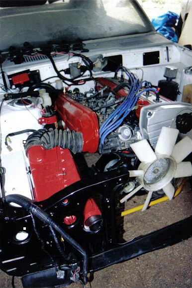

Here's a pic of Ray Fergusons (AKA Prince in forums) KPGC110 with RB20 .
The sway bar is yellow, SELBYS suspension, popular during the '70's was all yellow. Perhaps Ray has found an aftermarket selbys bar for his '70's Skyline? He may be able to help further.
I pinched the pic from an early Skylines thread over at Skylines Australia, thanks Ray.
