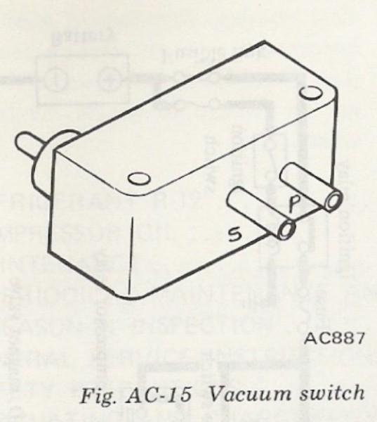

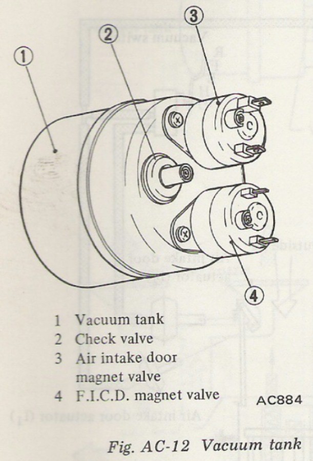

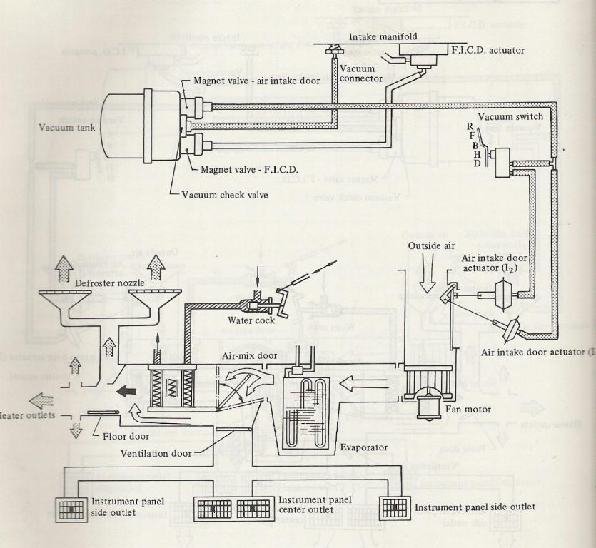

The cars that had dealer authorized non-factory ac didn't have the ficd system. They just set the idle a little higher to compensate for the ac load. (900-1000 rpm). There are quite a few components in the factory ficd system. I really don't know what you mean by 'the one that is actuated by the EGR valve. The ficd has it's own vaccum device on the intake manifold. It feeds vaccum to the cannister that houses the ficd actuator. Take a look at these scans that show the components of the ficd system. I guess you could transfer it over to your 260 but it looks like a lot of work. My 280 doesn't have it (ARA ac system) and my 810 does (factory air). The lack of it on my 280 has never been a problem.

I'm actually still here too!  Well, occasionally.  I ended up putting the FICD system in the car I mentioned above in post # 2 approaching 11 years ago.  It was actually easy.  I used the vacuum tank and magnet valves but I didn't use the vacuum switch.  I tapped into the power line to the compressor so when the compressor was switched on, the vacuum went to the FICD and raised the idle.  I haven't owned the car in over 6 years but the system was easy to figure out and worked flawlessly.  Unfortunately, since I don't have the car I can't take pictures of the setup.
