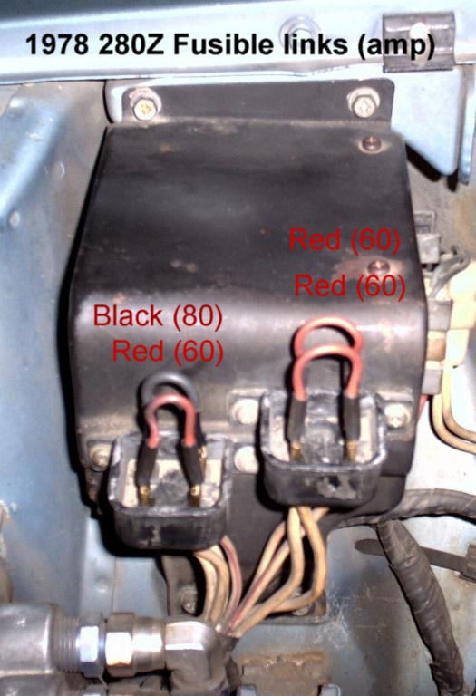

I understand what the large ones with the covers do, but whjat about the ones on the side of the relay box? I have a 78' that I would like to replace the fused links with auto-resetable ciurcuit breakers. Are the currents correct in this photo?
http://www.classiczcars.com/forums/attachment.php?attachmentid=6208
I thought they were like this:
headlights 20A
ignition 30A
igntion relay 30A
alternator 60A

The big question for me is which one protects which circuits? I only know of the one that goes to the headlamps.
BTW, why don't you have ant BROWN fuse links on your '78. Mine does, and it's in my owners book, Haynes book, and the MSA catalog.
Pete-
AFAIK, there are only the 5 fuse links on a '78, all under the hood. One goes from the battery (+) to the e.f.i. module, and the other four are on the shocktower, mounted to the relay cover, as in the photo.
