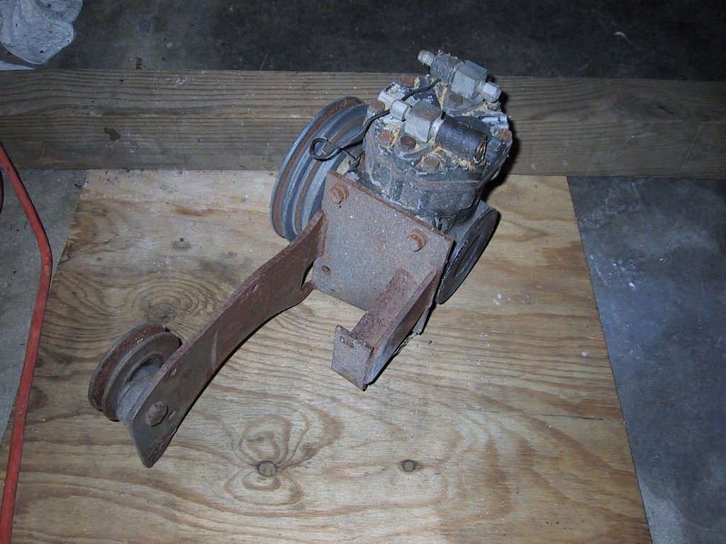

The pump doesn't look easy to change. their is some weird giant iorn bracket surrounding it with ~7 bolts holding it to the block and front cover. Otherwise i would have just changed it already. I guess i'll just remove the bracket and pump tomorrow and see what happens.

Inlet and Outlet Hoses and 2 nuts and one bolt should be the only things to remove in order to change the pump. Do you have a picture to post of the bracket you're referring to?
The bracket in question is for a dealer-installed A/C compressor. My car had exactly the same setup originally and I just happened to keep the unit after removing it years ago. The compressor itself is a Borg-Warner unit. I just put it on a scale and it weighs a whopping 32.5 pounds.
When I first bought my car one of the first repair jobs was replacing the fuel pump and I remember how that bracket was in the way. It's been so long that I can't remember if I had to remove it or could somehow get the fuel pump out while the A/C bracket was still in place.
