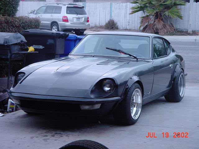

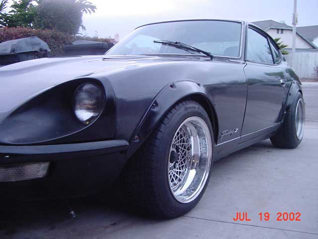

heres pictures of the epsilones on my z car,,,they are 15x9.5 front and 15x10 watanabes in the rear, nice rims i like them too,,,,

I'm thinking of going with 205's up front and 225's in the back. What does everyone think? 73skyline, thanks for the offer... I have a set of Libres that I'm probably gonna sell anyway. I'll clean up these enkies, try them out and if they're not exactly what I want maybe I'll talk to you about your set. Those Epsilons are sick rank up there with SSR reverse mesh. Too much money for me right now :(
