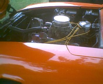

So, Im pretty serious about buying a 280z, and crammin in a 302 chevy. Im about to buy a rollin chassis, but i got to thinking about how cramped it is.
What are some common problems that v8z's have?
Is it hard to change plugs, oil filter, and so on.
How bout exhaust, i was lookin under a 280, and theres hardly any room.
What should i expect?
I have a 283 in my z-no problem with room-looks like i have so much room i could put a big block chevy in it!
Buy the JTR book!! Very informative and gives you 90% of the info you need.
So far as problems, high hp motors wreck the u-joints but the diffs seem to stay together very well, if you try to cut corners on the cooling system you will probably have problems, and remember to keep the weight of the engine down (as much aluminum as possible) to keep the weight distribution/handling as close to stock as possible. Good Luck!
