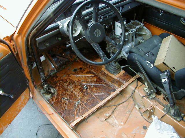

Hey guys sounds like we are all in the same boat. I get too many good tips from all of the replies. Making my life simpler! One question, Zues how did you get that f#$% tar paper off the floor without tearing everything up worse? You got it very clean. I was thinking about putting some stripper on it to "soften" it up and then try to scrape it off. My passenger pan( and probably rail from Mikes reply) is shot, but the driver is like yours just surface rust. I wouldn't touch the driver pan on mine but I worry about rust being underneath the paper. Nothing is coming through the bottom. I'm also getting a rust spot between the jack compartments. Where is that coming from? Its been dry for a long time.
I've got the answer to that one...
Get yourself a heat gun, heat until it softens and then scrape with any heavy duty scraper you have, finish off the remaining spots with Goo Gone (or was it called Goo Off??) - yellow 12 or 16oz container with a red logo and commonly found at Home Depot. Pour some on the tar, let soak for like 10sec and rub out with a rag... Good ventilation helps because that stuff gives you a headache after a while... Did three floorpans like that on the various cars I've owned and it came out perfect - Best part is that it doesn't attack the paint under the tar so provided you didn't get too crazy with your scraper you've got a nice clean floor pan when all is said and done.
-e
PS: Although I don't have a final clean pic of the floorpan of the pictured car handy right now take my word for it it came out super clean. Pic1 is initial 30yr old tar paper, Pic2 is after heat gun and scraper but before Goo Off applied...
I used a heat gun as well. However, instead of the commercial "goo gone" I used Xylene. Xylene is the main ingredient in the commercial goo removers and it's much cheaper to buy a quart of the stuff (also at Home Depot). I would advise working outside in the fresh air and/or using proper ventilation.
I used this method also, but I used plain old cheap as dirt Paint Thinner to remove the remaining "crusty bits" from the floor pan. Simple Simon!
