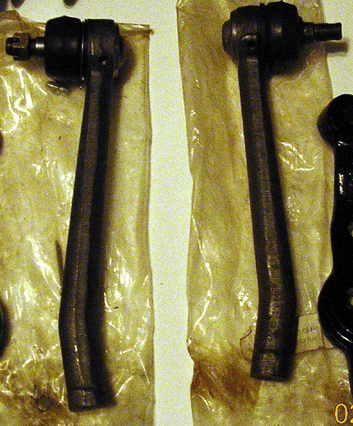

Here is one picture-the rest qre too dark-it is night time here, and I guess the flash just just isn't cutting it.
There is a left and a right, but the only dfference I could see is where the hole for the grease fitting is, they are mirrored in placement left to right. I do know Carl is right, they are threaded opposite.
I will be happy to take more pictures tomorrow if they will hlep.
Will
