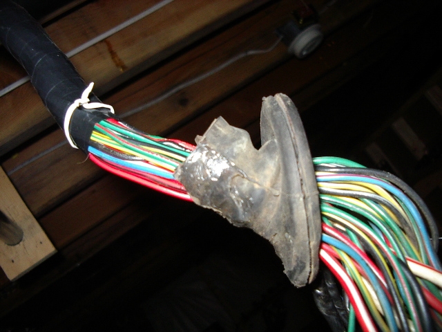

Ed, Do you have a good picture of the one you got? For reference. The grommet on my car has seen better days.

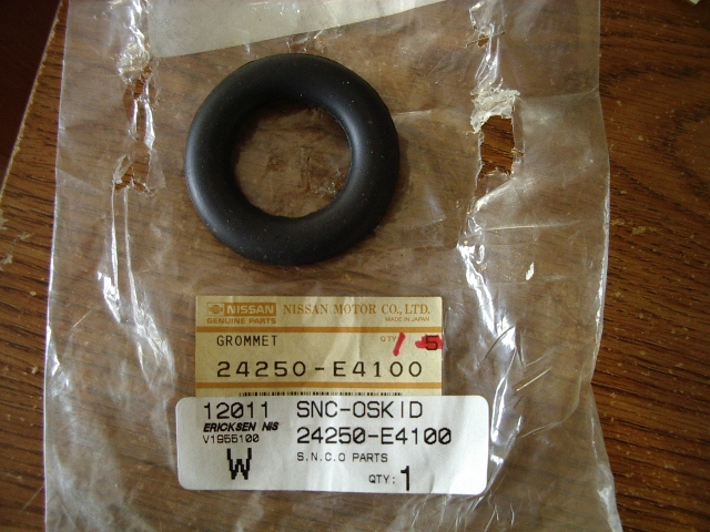

Here go some pictures. The first one is the original still on the wireing harness. I don't want to damage it by trying to remove it in case I can't find a replacement. The second picture is what they sent me. It matches the grommet that goes inside the car on the right rear corner, by the tail light.
Ed. Part 24250-e4100 Is The Correct Part #. The Part Has Changed In Looks.
Sometimes You'll Get Lucky And Get The Old Style. I've Got Some Good Used
Ones In Stock.i Gave You The Part # 24250-n4500 Because It's Closer To The Original One.the Inside Diameter Is Slightly Larger.but It Works And Looks
Stock.it Seals Up Better If You Use A Thicker Wire Wrap On The Harness.
Thanks for the pics. Wow, Significant differences. Seems like the "new" one would allow a lot of air through the firewall. Let us know how you eventually address the grommet issue.
I think the new one as shown in the pics is more for protection of the wiring harness as it passes over the metal of the body. The old one is for sealing purposes.
I dont believe they are interchangable. The newer one is as seen in the rear hatch area (remove your inner plastic trim panels).
