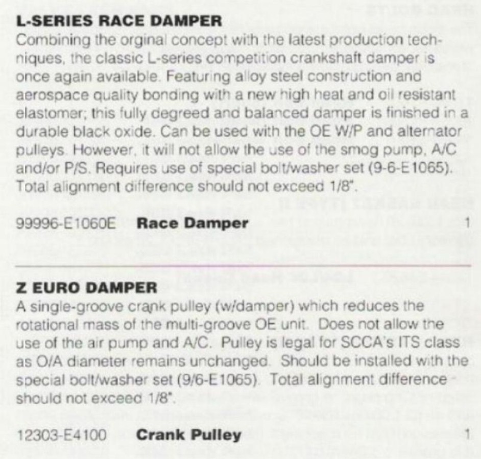

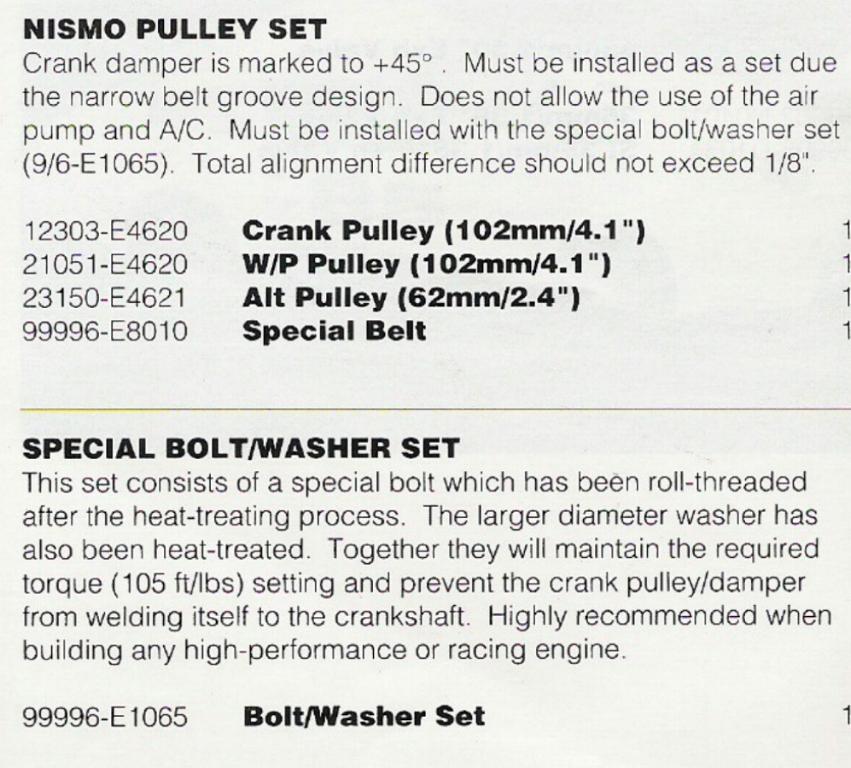

I had my harmonic balancer disingrate as well this year. I am also know of two others that failed on the race track this year. This can be very BAD! In one case the keyway was destroyed and the oil pump gear did not turn - new engine.
I invested in the Nissan racing HB - not inexpensive - but a must if you are turning big RPMs (more than 6000). Don't skimp here.
Where'd you find it and how much are we talking about...roughly?
You can get the Euro damper through motorsport http://www.zcarparts.com/store/merchant.mvc?Screen=CTGY&Category_Code=PEM06 and I know that this is a good peice. If you are turning big RPMs however you should consider the Nissan race damper through your local dealer - I will look up the part number when I get home.
