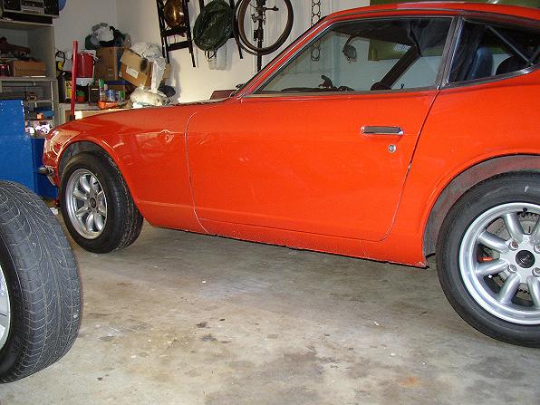

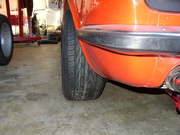

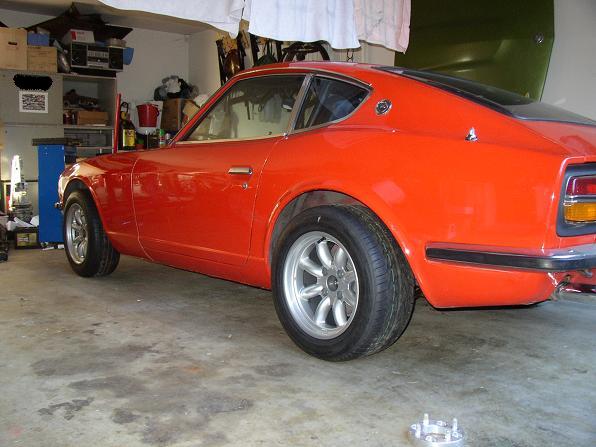

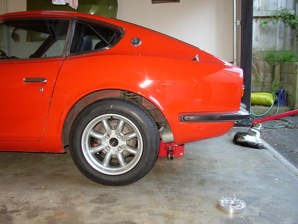

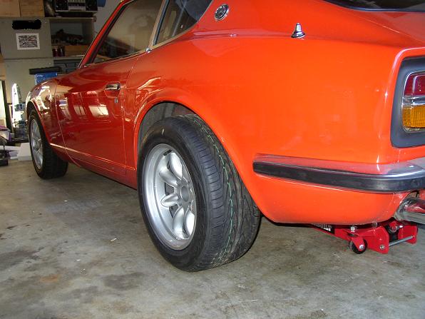

Guys here are a few pic of my new mags on another members 72 240z (thanks Glenn).
Mags are Compomotive ML (made in the UK) 15x7 -6 offset with 205/55/15 on the front and 15x8 -12 offset with 225/50/15 on the rear. My car is still in bits so Glenn was kind enough to let me put these on his car so I could see how the look.
My car has custom steel flares so I was looking for how they fit on stock guards/fenders. So from this I think might be looking to sell the 2 15x7 (fronts) and get another 2 15x8, same as the rears, for the fronts as my flares will be big enough to handle the 8s.

They look good, you should get some 245's for the rear if possible, I have a set on some SSR Longchamp XR4's at the moment and my brother tried them on the rear of his 240Z and they fit fine, with the offset of your rim and the flares your planning, I would think it would be a good idea, then run the 225's on the front if possible.

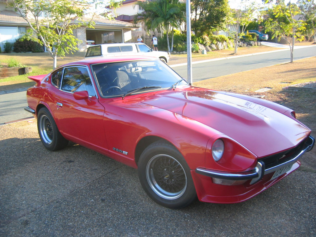

So im gonna put my simmons up for sale soon im thinkin. So im might as well start here, 15inch with 215/60/r15 tyres (so i guess 15*7?).
They are in great nick with a good chrome dish. Only one wheel has a tiny bit of paint missing next to the wheel nut where you can see the underneath, its in the pic attached a tiny dot next to the bottom front lug on the front wheel.
Hit me with some offers.
