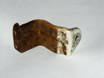

Scott. The part I sent attaches to a bracket which is welded in the car. It is on the left side about mid-way on the hatch opening. If the bracket is not there I will have to check to see if I still have the one in my parts car and you would have to have it welded in. :ermm: I will also try to get you a picture tomorrow of the bracket on my 72. JLP

On my 1972 the bracket is welded in two places at the point of origin (behind the plastic rear quarter trim) and under the lip of the rear hatch. On the 1973 parts car the bracket was welded at the point of origin and had two round head machine screws through the body hatch rail. The screws are about 1/4" long. I'm sure this is the reason for the holes in your rail. I will try and post some photos tomorrow. JLP

Scott, I have attached a photo of the original bracket to go with the part that I sent you. Due to the fact that this part is welded to the car I did not include it with the part I sent you which attaches to it. I removed it from the car this morning. On the left you can see the two spot weld points and near the right end you can see the two holes for the machine screws. If you need this part let me know. JLP
OK I'm pretty sure I never had that part on my car. I think mine must have been bodged up somehow by the PO. I will have a muck around with it, and try have a look at Gee's car and See it I can work something out. Should be able to make it work somehow.
