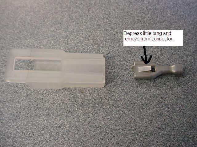

Hi Brandy, if I may make a suggestion, get yourself a dentist's pick. Then you can remove the terminal and wire completely from your old harness connector and swap in the wire/terminal assy from your new harness. The terminals have a little tang that if depressed with the pick will allow you to remove them from there respective connectors. I have done this many times. It takes some patience but its better than cutting and splicing.
FWIW,
Chris
