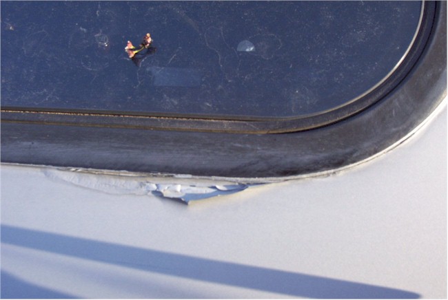

I'm also wondering if I could super-fine sand the flaking pictured below to keep it from getting worse, kind of smooth it all out. I think it's just from too much paint and poor masking when the PO painted it.

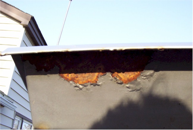

The worst visible rust on the car is under my hatch, also pictured below. I'm pretty sure it's rusted through the metal, at least by a pinhole or two. I'm wondering if I should attack it to slow it down, then start looking for a rust-free hatch, or if it's cost-effective (and realistic) to save it.

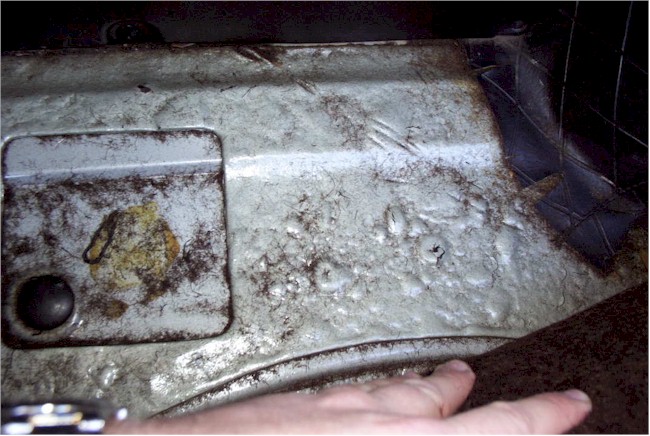

Last but not least, there's some scary bubbling underneath my hatch carpet, on the driver's side, behind the wheel well and next to the spare tire well. I'm not sure if there's rust underneath because there's some kind of rubberized gunk under the paint. Hopefully the paint is just bubbling? If it's rust, I imagine it's through the metal by now and probably a nightmare to fix due to it's location.

Now regarding your paint around the sunroof and hatch, from the paint ON the gasket, it's apparent that the peeling you are experiencing is from water seepage beneath the paint. The only fix that I know of, is to sand down and apply a new small shot of paint in such a way as to avoid the lip. Unfortunately, it is tricky and it is usually better to remove these items in order to avoid such a lip in the first place.
The rust on the hatch, give it a spot treatment and leave it for later. POR-15 makes a good product to help slow / stop that rust. Try to get some into that area from the inside of the panel.
The bubbling of the tar paper is typical. All you can do is scrape it off, fix the rust / holes etc and reapply the tar paper.

The paint flaking on your roof can stopped rather quickly (about 15-20 minutes). Flake off all the raised, loose portions of paint, then sand the edges smooth, but don't sand too much. Don't sand into the underlaying paint. Once you have sanded the edges, then take some clear nail polish (ask your wife/girlfriend/or just some woman at work) and paint the edges. This will help keep water from seeping under the edge of the paint and making it flake up more. (Note: this is only a temporary fix to allow you to focus on other things.)
The issues with your hatch are directly related to rust, nothing else. The only thing to do for now is like EScanlon said, put some sort of treatment on it, inside and out, and focus on ther things. A complete swap of a good hatch is best, and a repair of the hatch will take quite some time. For now, treat it and leave it.
As for the bubbles in your tar inside, I had some just like that on my floor boards. When I peeled it up, there wasn't any rust just clean shiney metal. The bumps were just from irregularities in the tar mat. The only way you'll know for sure is to peel it up.
Get your self a heat gun or a halogen work light and place it close (but not too close, about 3") to the tar for about 1-2 minutes. Then take a putty knife and slide it under the tar mat. It should be pliable enough to just peel up. Then you can see how it looks underneath.
