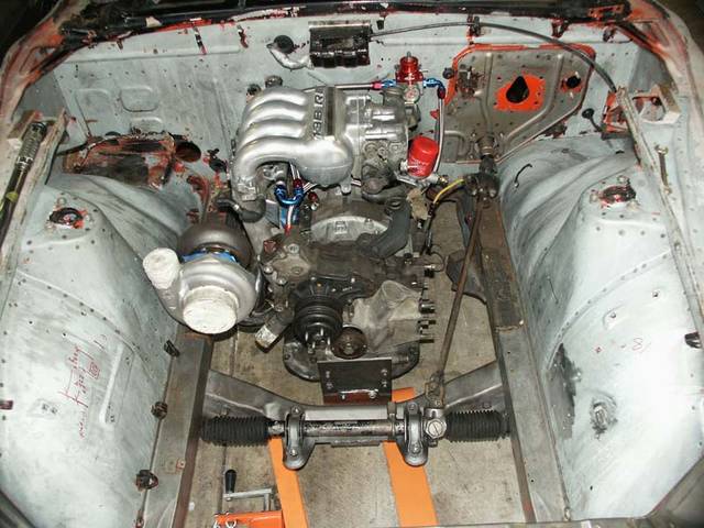

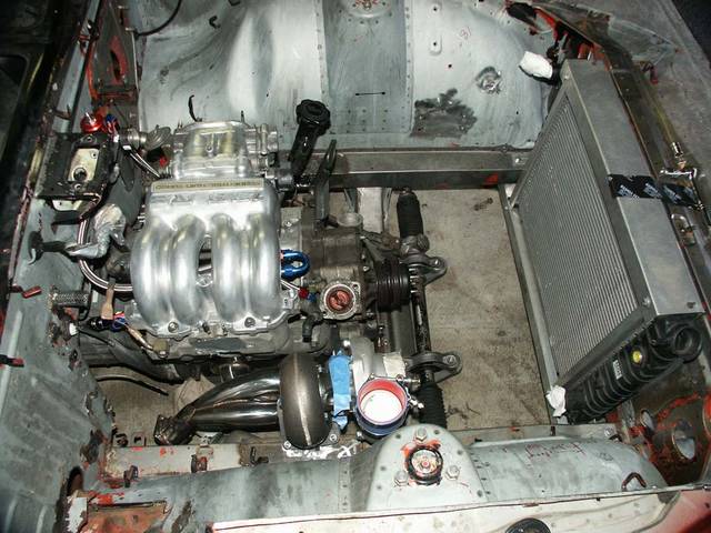

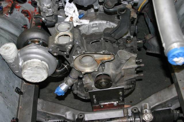

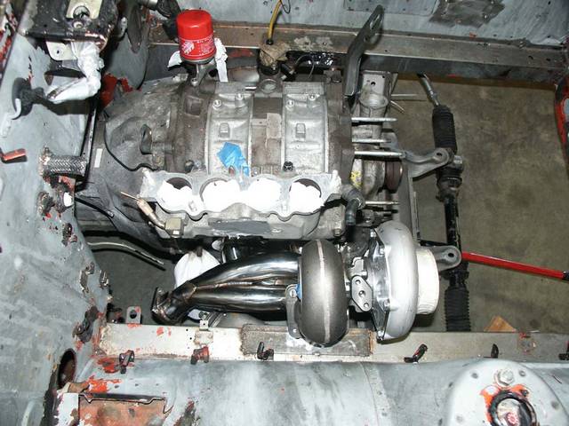

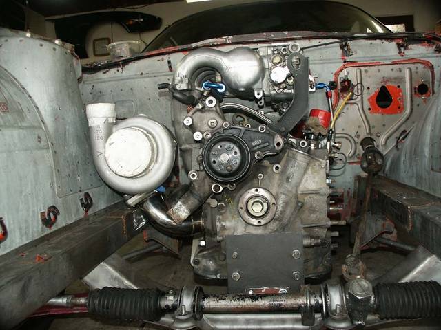

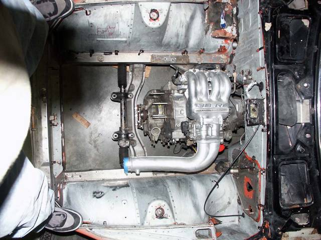

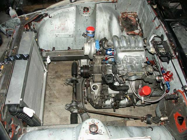

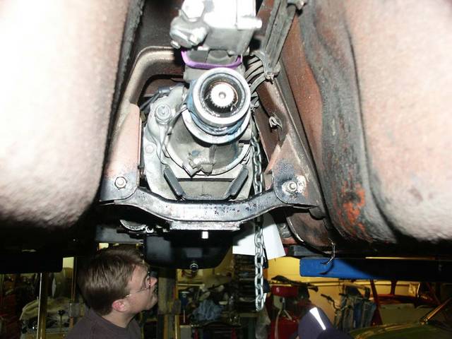

Got a ways to go, had to completely scrap and redesign teh mounts. Side mounts didn't fare too well, so I opted to cheat, and used an '82 12a rx-7 front engine cover with front mount bolt points (same as 510 guys use). Will have to modify the oilpan, but otherwise now it's bolted to the crossmember. have to add a few reinforcements here and there, and a panhard type bar for the side of hte motor so it doesn't travel left/right on turns.

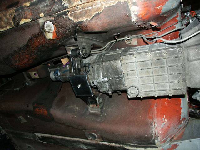

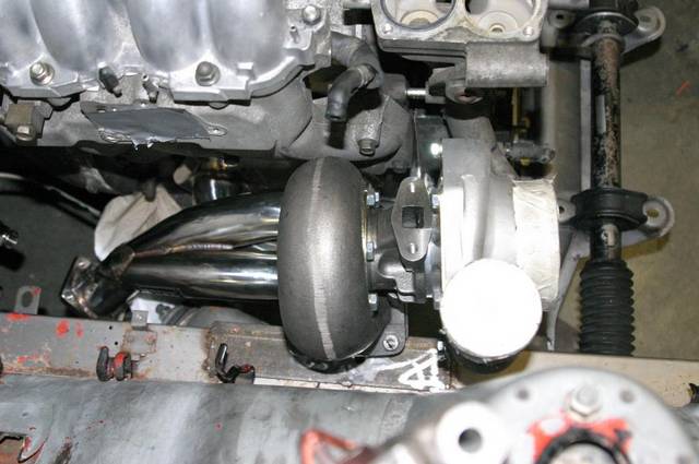

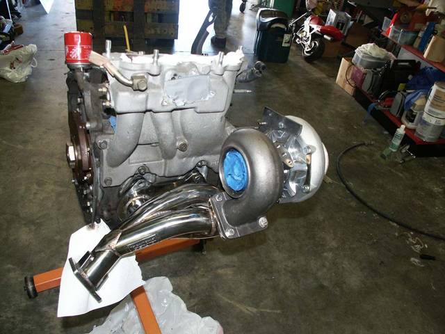

Motor is a 13B-RE, originaly twin turbo, now converted to single garrett t04s 60-1. Fuel is managed through a parallel -6an fuel rail setup, fed by -8an line from a fuel cell, into 550cc primary, and 1,680cc secondaries. Transmission is an rx7 turbo unit, and it even bolts up to the stock location :) The only downside is that this combo puts oilpan really low to the ground....a little bit below frame rails.
